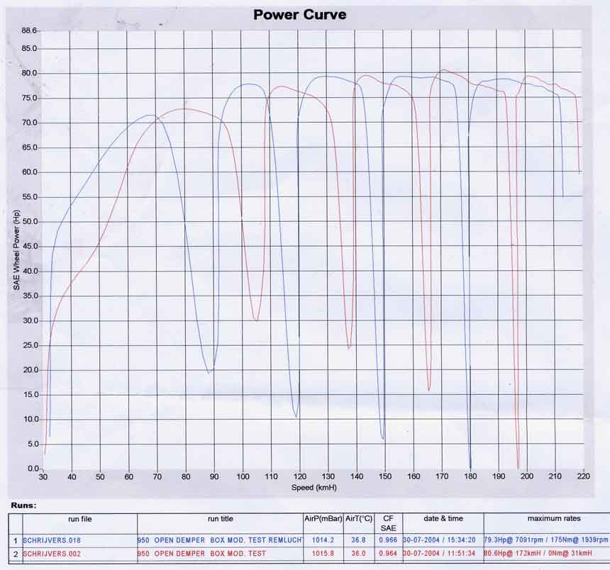

Hi,
I'd like to have your opinions on the power curve my of LC8.
The engine had a terrible dip in the lower rev range, so my dealer had the engine fine tuned by Ruud Fredriks (the Dutch dynojet importer).
It took them quite some time, but the result was that the dip was gone and the engine had a lot more torque. From 84 Nm to 93 Nm. Overall the machine finally drove smoothly.
However I'm not sure if I should be happy with the result. It seems that the engine still is missing a lot of top-end power only 79.6 Hp at the wheel. According to the guys at Ruud Fredriks's there was not much potential left to gain top-end power. I have not fully tested top speed. But I don't think I will reach the 220-230kph on the clock as stated elsewhere in this forum. The bike is already accelerating very slowly at 190kph.
My LC8 has akra's without DB-eater and has the Sommer luftfilter.
Thanks,
Bastiaan

There was a test in an austrian magzine, and I think they measured something around 98hp in the rear wheel. I´m not shure, if this was with or without acrapovic and summers door.
If somebody has that test - I think it was Reitwagen - then please tell RoadRunner.

@ Rainer,
laß mal, wir hatten die Diskussion schon mal. Simon ist da nicht zu überzeugen. V.a. da sein 60PS Diesel fast genauso schnell is mit seinem GPS. Razz
@bastiaan: Usually the test benches allow to measure the power at the clutch since they break down (after the test run) the Rear wheel (and of course the gear box) and measure the power they need to do this. Then they add this to the measured power (since it represents the power loss in the drive train) and you have the power on the clutch.
You don't have this curve?
Do you know in which gear the measurement was done?

Würde einer der Diagnostiker so freundlich sein und mir das Diagram erklären.
Danke, Peter

@bruggma
Also wenn ich das richtig deute, dann haben wir
links die PS/kW am Hinterrad,
rechts das Drehmoment und
unten die Umdrehungen pro Minute.
blaue Kurve vor Modifikation
rote Kurve nach Modifikation
die Kurve mit den Punkten ist das Drehmoment
die Kurve ohne Punkte ist die Leistungsabgabe
Man kann erkennen, das beide Kurven , Leistung und Drehmoment insgesamt linearer und mit weniger Einbrüchen verlaufen.
Auch ist die Leistungabgabe nach der Modifikation am höchsten Punkt der Kurve höher und der Motor entwickelt mehr Drehmoment.
kann die Beschriftung aber nur schlecht lesen, da das Bild beim vergrößern sehr pixelig wird.
Entweder war das Datum nicht richtig eingestellt, oder er fährt schon fast zwei Monate mit der Modifikation rum.
VG Schimmi

Was mir auch aufgefallen ist, ist der Einbruch bei ca 3500 - 4000 im Originalzustand, den kenn ich so nicht, zumindest nicht subjektiv, und v.a. daß bei der einen Messung der Drehzahlbegrenzer bei ca. 8200 bei der andern bei 8800/min greift.
Wenn da die Übersetzungen falsch eingegeben wurden würde das so einiges erklären <_<

RoadRunner hat folgendes geschrieben:
Hi,
Mein (2004) LC8S fühl etwa an wie die Curve deiner Machine: Ist nicht sehr schlimm aber, ich werde doch auch versuchen raus zu finden was da Schief geht (ich denke das ist meistens der Mischung)
Mir fehlt auch etwas top-end power, max geht der so 210 auf dem tacho und fühl sich an wie zu ärme Mischung bei vollgas(!).
(Wenn mein Händler in Holland das nicht lösen kann (weil die keine Dyna-bank hat) gehe ich mal zu Sommer und versuche es dort, hoffentlich alles in Zusammenarbeitung und mit Rückspache.)
1e frage: Ist deine Machine 2003 oder 2004? (ich habe noch immer das gefuhl die sind kleine unterschieden)
2: Die end-rpm bei 8200/8700 rpm? das kann ja nicht richtig sein. Sowie Max-ps bei 7200rpm.. da stimmt etwas nicht.
3: Welche Änderungen sind dann so etwa gemacht??

Thanks for your replies!
My lc8 is an 2003.
The guys at Ruud Fredriks changed the following:
- Larger main jets ( Hauptdüsen )
- closed the bremsluft
First they tried a bigger needle. But that didn't give enough fuel. The engine was way to lean in the lower rev range. In upper rev range they said the couldn't improve much since there the mixture was already very good.
My lc8 (at the wheel):
80hp/7300rpm
93nm/5500rpm
Factory specifications (at the clutch):
98hp/8000rpm
95nm/6000rpm
So that is a power loss of 18hp which is a lot more then the 8 to 10% that is assumed to be normal for chain driven bikes. Other bikes that they have measured indeed show a loss in this range. Maximum power is also reached at much lower rpm (7300 instead of 8000) then the factory specification.
However only 2nm torgue loss.
I don't know in which gear the power curve was measured, but they also measured the power through the gears. See the chart (sorry for the low resolution but the upload size seems to be restricted to 50kb.
To me it seems there still is something wrong with engine that prevents it from reaching more power at a higher rpm.
Bastiaan
ps1. Normally this fine tuning costs around EUR 300,-. But my dealer (Paashuis) made some arrangements, since the engine was running so poorly.
ps2. The date is correct. I went on holiday etc...
